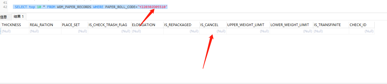

SQLserver遇到了奇怪的问题
image.png这条数据的IS_cancel字段是空值

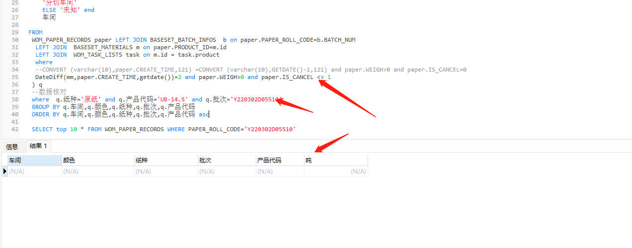

image.png我的另一端SQL加入了这个字段作过滤,过滤掉等于1的,但是这条数据夜查不出来了,请问是啥情况
 SELECT
 q.车间,
 q.颜色,
 q.纸种,
 q.批次,
 q.产品代码,
  sum(q.重量)/1000 吨
FROM
 SELECT distinct paper.PAPER_ROLL_CODE 批次,
 case m.COLOR when 'BaseSet_color/yellow' then '本色' when 'BaseSet_color/white' then '漂白'  else '其他' end 颜色,
 case m.PRODUCT_CODE  when null then '其他' else m.PRODUCT_CODE end 产品代码,
 paper.WEIGH 重量,
 case SUBSTRING(paper.PAPER_ROLL_CODE,1,1) when 'Y' then '原纸' when 'F' then '分切纸' when 'A' then '分盘纸' else '其他' end 纸种,
 CASE
    WHEN cast(SUBSTRING(paper.PAPER_ROLL_CODE, 9, 2) as int) Between 01 and 04 THEN
    '一车间'
    WHEN cast(SUBSTRING(paper.PAPER_ROLL_CODE, 9, 2) as int) Between 05 and 08 THEN
    '二车间'
    WHEN cast(SUBSTRING(paper.PAPER_ROLL_CODE, 9, 2) as int) Between 09 and 14 THEN
    '三车间'
    WHEN cast(SUBSTRING(paper.PAPER_ROLL_CODE, 9, 2) as int) Between 51 and 99 THEN
    '分切车间'
    ELSE '未知' end
    车间
FROM
 WOM_PAPER_RECORDS paper LEFT JOIN BASESET_BATCH_INFOS  b on paper.PAPER_ROLL_CODE=b.BATCH_NUM
  LEFT JOIN  BASESET_MATERIALS m on paper.PRODUCT_ID=m.id
  LEFT JOIN  WOM_TASK_LISTS task on m.id = task.product
  where
  DateDiff(mm,paper.CREATE_TIME,getdate())=2 and paper.WEIGH>0 and paper.IS_CANCEL <> 1
 ) q
 where  q.纸种='原纸' and q.产品代码='UB-14.5' and q.批次='Y220302D05510'
 GROUP BY q.车间,q.颜色,q.纸种,q.批次,q.产品代码
 ORDER BY q.车间,q.颜色,q.纸种,q.批次,q.产品代码 asc
 SELECT top 10 * FROM WOM_PAPER_RECORDS WHERE PAPER_ROLL_CODE='Y220302D05510'

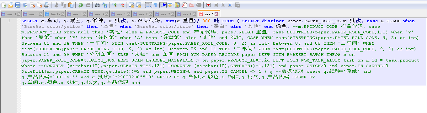

  • 无为而无不为 无为而无不为(提问者) SELECT q.车间, q.颜色, q.纸种, q.批次, q.产品代码, sum(q.重量)/1000 吨 FROM ( SELECT distinct paper.PAPER_ROLL_CODE 批次, case m.COLOR when \'BaseSet_color/yellow\' then \'本色\' when \'BaseSet_color/white\' then \'漂白\' else \'其他\' end 颜色, --m.PRODUCT_CODE 产品代码, case m.PRODUCT_CODE when null then \'其他\' else m.PRODUCT_CODE end 产品代码, paper.WEIGH 重量, case SUBSTRING(paper.PAPER_ROLL_CODE,1,1) when \'Y\' then \'原纸\' when \'F\' then \'分切纸\' when \'A\' then \'分盘纸\' else \'其他\' end 纸种, CASE WHEN cast(SUBSTRING(paper.PAPER_ROLL_CODE, 9, 2) as int) Between 01 and 04 THEN \'一车间\' WHEN cast(SUBSTRING(paper.PAPER_ROLL_CODE, 9, 2) as int) Between 05 and 08 THEN \'二车间\' WHEN cast(SUBSTRING(paper.PAPER_ROLL_CODE, 9, 2) as int) Between 09 and 14 THEN \'三车间\' WHEN cast(SUBSTRING(paper.PAPER_ROLL_CODE, 9, 2) as int) Between 51 and 99 THEN \'分切车间\' ELSE \'未知\' end 车间 FROM WOM_PAPER_RECORDS paper LEFT JOIN BASESET_BATCH_INFOS b on paper.PAPER_ROLL_CODE=b.BATCH_NUM LEFT JOIN BASESET_MATERIALS m on paper.PRODUCT_ID=m.id LEFT JOIN WOM_TASK_LISTS task on m.id = task.product where --CONVERT (varchar(10),paper.CREATE_TIME,121) =CONVERT (varchar(10),GETDATE()-1,121) and paper.WEIGH>0 and paper.IS_CANCEL=0 DateDiff(mm,paper.CREATE_TIME,getdate())=2 and paper.WEIGH>0 and paper.IS_CANCEL <> 1 ) q --数据核对 where q.纸种=\'原纸\' and q.产品代码=\'UB-14.5\' and q.批次=\'Y220302D05510\' GROUP BY q.车间,q.颜色,q.纸种,q.批次,q.产品代码 ORDER BY q.车间,q.颜色,q.纸种,q.批次,q.产品代码 asc

  • Z4u3z1 Z4u3z1 回复 无为而无不为(提问者) 可以把SQL 贴到问题描述里么? 里面有注释不知道怎么断句了...
    2022-05-10 16:41
  • 无为而无不为 无为而无不为(提问者) 我把这个过滤条件去掉就能查出来
    2022-05-10 16:41
  • 无为而无不为 无为而无不为(提问者) 回复 Z4u3z1 加入了
    2022-05-10 16:43
  • Z4u3z1 Z4u3z1 回复 无为而无不为(提问者) 你看我的图没法断句.........
