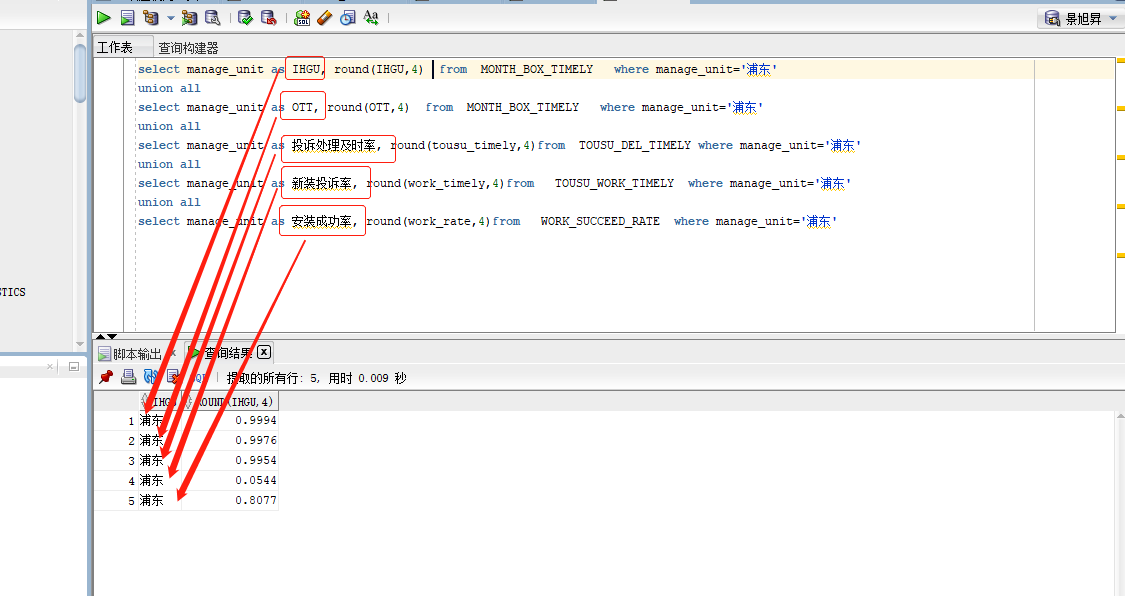

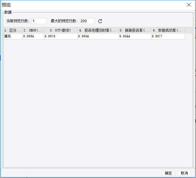

最新问题 是最后的语句对了  但是前面的as值没有更改
select
a.manage_unit    as 区分, round(a.IHGU,4) as IHGU,  round(a.OTT,4) as OTT,  round(b.tousu_timely,4) as 投诉处理及时率, round(c.work_timely,4) as 新装投诉率,
round(d.work_rate,4)  as 安装成功率
from
 MONTH_BOX_TIMELY A,
 TOUSU_DEL_TIMELY B,
 TOUSU_WORK_TIMELY C,
 WORK_SUCCEED_RATE D
 where  a.manage_unit=b.manage_unit  and  b.manage_unit=c.manage_unit  and  c.manage_unit=d.manage_unit
and  a.manage_unit='浦东'
不知道应该怎么在select中  将这个表给它转置,希望哪位大神可以指点一二!!!小生万分感谢
select manage_unit as IHGU, round(IHGU,4)  from  MONTH_BOX_TIMELY   where manage_unit='浦东'
union all
select manage_unit as OTT, round(OTT,4)  from  MONTH_BOX_TIMELY   where manage_unit='浦东'
union all
select manage_unit as 投诉处理及时率, round(tousu_timely,4)from  TOUSU_DEL_TIMELY where manage_unit='浦东'
union all
select manage_unit as 新装投诉率, round(work_timely,4)from   TOUSU_WORK_TIMELY  where manage_unit='浦东'
union all
select manage_unit as 安装成功率, round(work_rate,4)from   WORK_SUCCEED_RATE  where manage_unit='浦东'

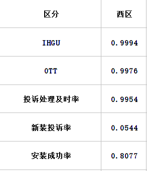

类似这种,用union all 简单拼接下。
select 'IHGU' as '区分', round(a.IHGU,4) as '西区' from 表
union all
select 'OTT' as '区分', round(a.OTT,4) as '西区' from 表
  • Elison_man Elison_man(提问者) 我按照你的方式更新了一下 大致出来了 但是还有一个小问题 麻烦您给解决一下 ,我把图贴到上面吧

  • Elison_man Elison_man(提问者) select \'IHGU\', round(IHGU,4) from MONTH_BOX_TIMELY where manage_unit=\'浦东\' union all select \'OTT\', round(OTT,4) from MONTH_BOX_TIMELY where manage_unit=\'浦东\' union all select \'投诉处理及时率\', round(tousu_timely,4)from TOUSU_DEL_TIMELY where manage_unit=\'浦东\' union all select \'新装投诉率\', round(work_timely,4)from TOUSU_WORK_TIMELY where manage_unit=\'浦东\' union all select \'安装成功率\', round(work_rate,4)from WORK_SUCCEED_RATE where manage_unit=\'浦东\'
    2019-11-12 11:42
  • Elison_man Elison_man(提问者) 好了 谢谢您了
    2019-11-12 11:42
  • free_zz free_zz 回复 Elison_man(提问者) 新弄一列,就取你想要的名字
