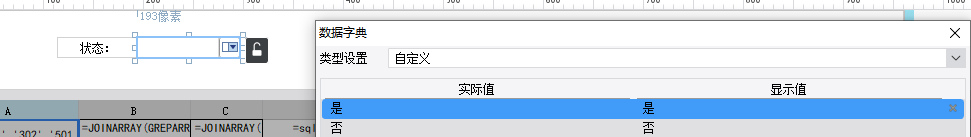

怎么调整这个if判断
project_status 在数据库里有 0,空,1 三个数值,现在想status等于是的时候 查 空,1的数据,等于否的时候查0的数据
FineReport yzmikrWe3651420 发布于 2025-4-9 15:48
共4回答
发布于2025-4-9 15:50
${if(status="是"," and (project_status is null or project_status='1' )"," and project_status='0'")}
  • yzmikrWe3651420 yzmikrWe3651420(提问者) 控件值里面没有数值的时候 还是查全部 这个判断也要合进去
    2025-04-09 15:51
  • snrtuemc snrtuemc 回复 yzmikrWe3651420(提问者) ${if(len(status)=0,"",if(status="是"," and (project_status is null or project_status='1' )"," and project_status='0'"))}
    2025-04-09 15:54

发布于2025-4-9 15:50
and t.project_status in('{start}')
Z4u3z1Lv6专家互助
发布于2025-4-9 15:53
${if(len(status)==0,"",if(status="是"," AND project_status IN('1','')"," AND project_status IN('0')"))}
MKERALv6初级互助
发布于2025-4-9 15:54
${if(status = '是',"and t.project_status <> 0","and t.project_status = 0")}
