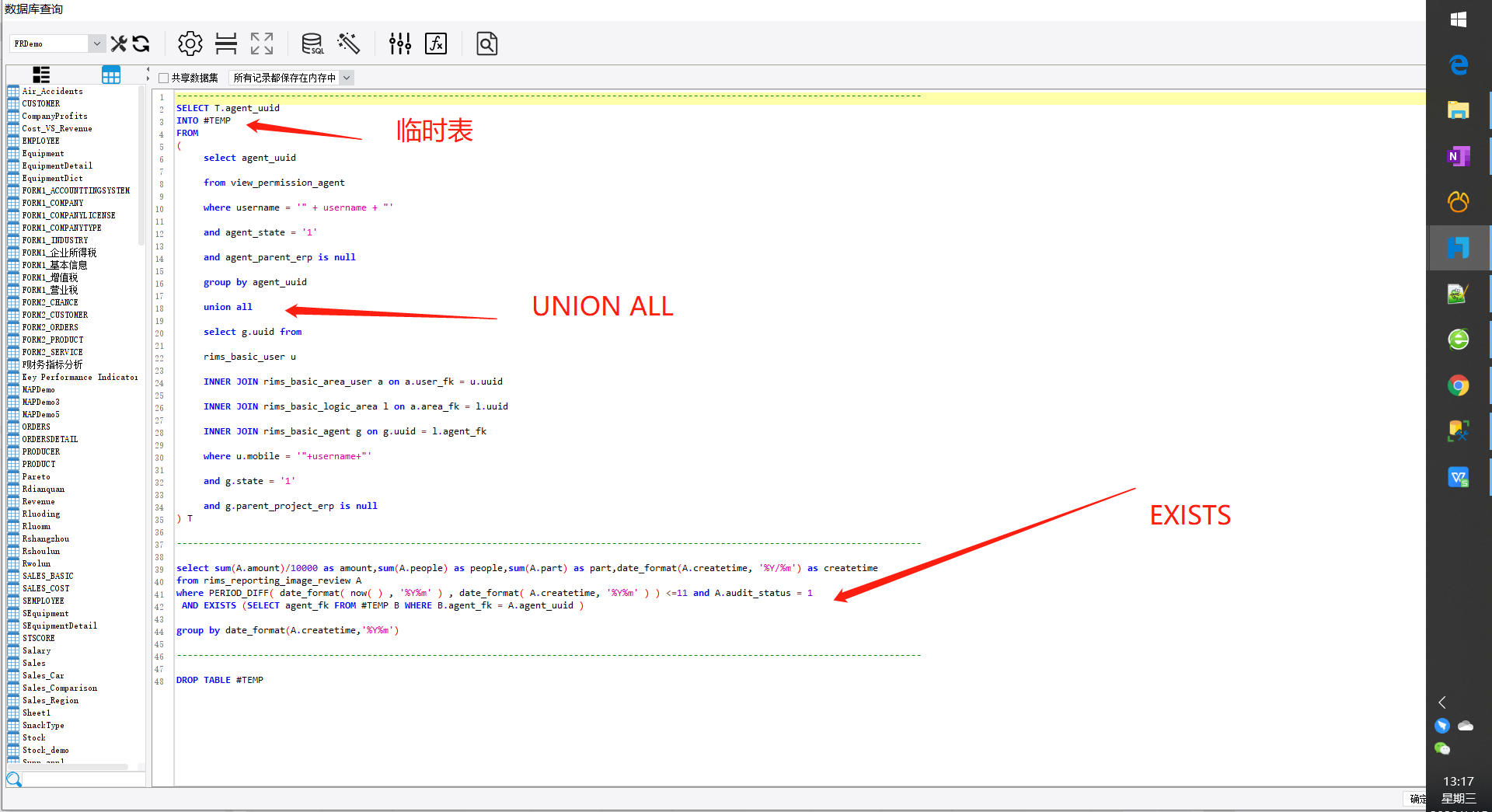

这是个性能问题,你这个脚本里有几处是明显没有经过性能调优的:
  1. 不要用in,用exist
  2. 尽量不要在表达式中用函数比如这里的PERIOD_DIFF,拆分成and条件都比这个快
  3. 不要用union,用union all 因为union会自动执行 SELECT DISTINCT all columns 操作
  4. 尽量不要用is null ,比如g.parent_project_erp is null ,当然这里需要其他部门配合了
另外,建议你在sql中使用临时表,
SELECT T.agent_uuid
INTO #TEMP
FROM
select agent_uuid
from view_permission_agent
where username = '" + username + "'
and agent_state = '1'
and agent_parent_erp is null
group by agent_uuid
union all
select g.uuid from
rims_basic_user u
INNER JOIN rims_basic_area_user a on a.user_fk = u.uuid
INNER JOIN rims_basic_logic_area l on a.area_fk = l.uuid
INNER JOIN rims_basic_agent g on g.uuid = l.agent_fk
where u.mobile = '"+username+"'
and g.state = '1'
and g.parent_project_erp is null
) T
select sum(A.amount)/10000 as amount,sum(A.people) as people,sum(A.part) as part,date_format(A.createtime, '%Y/%m') as createtime
from rims_reporting_image_review A
where PERIOD_DIFF( date_format( now( ) , '%Y%m' ) , date_format( A.createtime, '%Y%m' ) ) <=11 and A.audit_status = 1
 AND EXISTS (SELECT agent_fk FROM #TEMP B WHERE B.agent_fk = A.agent_uuid )
group by date_format(A.createtime,'%Y%m')
DROP TABLE #TEMP
如果还是性能有问题,你需要
  1. 开启帆软共享内存或者磁盘
  2. 给unionall 上下两端表格中根据你的where条件和 inner条件 添加索引
