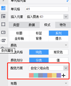

仪表盘用它,可实现渐变效果
图例的话单独做个报表叠加
  • FR小菜鸡 FR小菜鸡(提问者) 这个组合色不是控制不同的分类显示不同的颜色吗??每个仪表盘还是纯色

  • 15922204585 15922204585 回复 FR小菜鸡(提问者) 预览出来有渐变效果
    2021-09-13 11:13

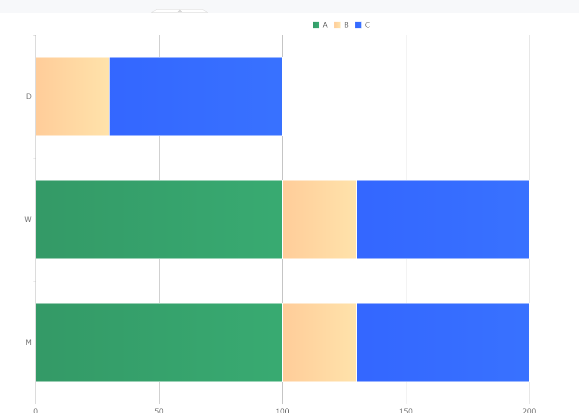

先按 month week day 排序, 然后 act plan goal 排序 出来就是正常的顺序啊
with x as(
select 'M' as c_date,'A' as c_type,100 as je from dual
union all
select 'M' as c_date,'B' as c_type,30 as je from dual
union all
select 'M' as c_date,'C' as c_type,70 as je from dual
union all
select 'W' as c_date,'A' as c_type,100 as je from dual
union all
select 'W' as c_date,'B' as c_type,30 as je from dual
union all
select 'W' as c_date,'C' as c_type,70 as je from dual
union all
select 'D' as c_date,'B' as c_type,30 as je from dual
union all
select 'D' as c_date,'C' as c_type,70 as je from dual
selecT *  from x
order by case when c_date='M' then '01'
when c_date='W' then '02'
when c_date='D' then '03' end,
case when c_type='A' then '01'
when c_type='B' then '02'
when c_type='C' then '03' end

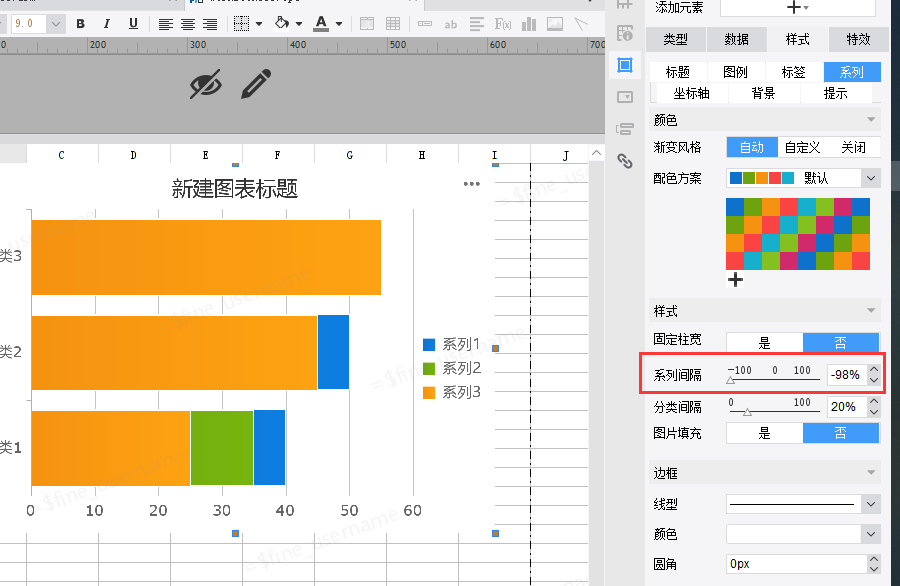

  • FR小菜鸡 FR小菜鸡(提问者) 你用的是堆积条形图,我想实现的是如果Actual是1500,Plan是1600,那么黄色的形状其实只显示100.所有系列都是从X=0开始显示.并且提示的时候还是提示1500、1600,而不是提示1500、100.
    2021-09-13 11:07
  • wukaihua wukaihua 回复 FR小菜鸡(提问者) 不好意思,没从你的问题描述中获取这个信息,我以为只是图例跟系列的顺序问题
    2021-09-15 15:25

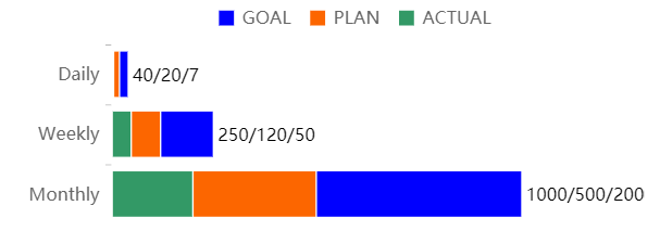

发布于2022-3-18 20:28
目前测试,这个图例第一个在最底层,最后一个在最上层,没有地方调整
